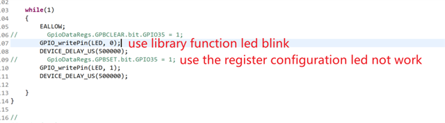

    I have run the LED blinky example in the C2000Ware SDK V5.02.I only change GPIO_writePin(49,0) to GpioDataRegs.GPBDAT.bit.GPIO49 = 0,but it didn't seem to work

  • I  have deleted syscfg! I want to configure GPIO pinmux  register myself.here's my main.c

    I have tried single step-in inside the for loop and checked the register view to check the register value not change when I use GpioDataRegs.GPBDAT.bit.GPIO49 = 1 to configure GPIO output level; but the led can blink when I use GPIO_writePin(49, 0) to configure  GPIO output level.

  • I tried to toggle the led using the instructions you suggested to me.But it still didn't work.

  • Can you try F280015x_Launchpad? I tried it here but it didn't work and the compilation will come with the warning(#10247-D creating output section "GpioCtrlRegsFile" without a SECTIONS specifiaction). Looks like I'm missing some configuration.
    Why didn't you have this warning? or do you also have this warning,but you can run it successfully?
    Please link f280015x_globalvariabledefs.c file into the project at location - C2000Ware_5_02_00_00\device_support\f280015x\headers\source
    You can also use the empty bitfield driverlib example present in the SDK and modify the main.c file in the example - C2000Ware_5_02_00_00\device_support\f280015x\examples\empty_projects . This example already has the globalvardefs already lonked in the example.
