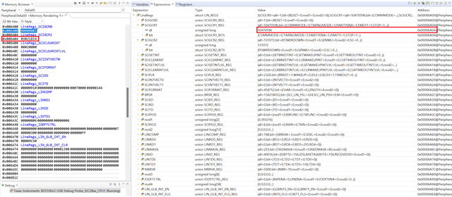

However, it was confirmed that Lin-related addresses were incorrectly allocated when using Bootloader.
Below is the Register map when the Bootloader is not available.
Below is the register map when using the bootloader.
Please advise why the two register assignments are different.

    A few questions for you: Could you please help to provide a bit more context as to what you are changing between the two runs (without bootloader vs. with). Which bootloader are you using- could you explain at a high level the steps the bootloader is going through? Are you just booting from flash or some other peripheral? Are there any other changes at all between the two cases (without vs. with) or changes in the included project files? Or is the only change the addition of the bootloader?
    Do you still see the missing LIN registers in the 'Registers" view of CCS? For example, there is no LinaRegs_SCIGCR1 in the case with the bootloader - is this also undefined in the Registers view?

    The first picture is the register check result of CCS_12ver's LIN communication example "lin_ex4_loopback_polling", and
    the second picture is the register check result of our company's project file of CCS_10ver.
    There are many differences between the two projects that are difficult to explain.
    If you mention anything you would like to check, we will provide you with additional information.

  • https://e2e.ti.com/support/tools/code-composer-studio-group/ccs/f/code-composer-studio-forum/753701/ccs-tms320f28376s-memory-map-prevented-reading-0x000480xx-data
    I am interested in this, so I checked, and as a result, I confirmed that the value at the memory address on page 3 (Peripheral) matches.
    However, I confirmed that the register that should be 32 bits is 16 bits. Looking at the expressions, the bits were declared correctly.
    cmd is using f28004x_flash_cpu_is and f28004x_headers_nonbios. However, there is a slight difference in content from f28004x_flash_cpu_is and f28004x_headers_nonbios in C2000Ware_MotorControl_SDK_4_01_00_00.
    However, we could not find any problems caused by the differences.

  • The company project file is using version ccs10, and the example file was opened in version 12. However, I know that regardless of the version, both CCS10 and 12 must be located at the same address. Is this just one of those bugs that occurs with lower CCS versions?
  • Hi Allison,
    https://e2e.ti.com/support/microcontrollers/c2000-microcontrollers-group/c2000/f/c2000-microcontrollers-forum/986832/tms320f280049-lin-register-of-tms320f280049c-is-not-normal
    This link helped me a lot. The lin-related xml of the ccs10 version has been changed to that of the 12 version. It's back to normal. Thank you for your help in resolving the issue.
