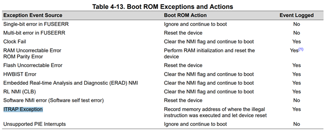

Hi All,
If an "ITRAP Exception" occurs in the table, where is this error logged and how can I check the logged error?

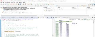

Hi Ito-san,
Once you are in ITRAP, you can load the bootrom symbol from C2000Ware_x(whatever version you have)/libraries/boot_rom/f28003x/rev0/rom_sources/ccs_files/cpu/Release/F28003x_ROM.out. In CCS do this through Run->Load Symbols. Once symbol is loaded, you can load the sources to view variable CPU1BROM_itrapAddress in the expressions window as shown:
Point the sources to C2000Ware_x(whatever version you have)/libraries/boot_rom/f28003x/rev0/rom_sources/F28003x_ROM/bootROM/source
Anyway, ITRAP address will be stored in 0x0000001E for F28003x as shown in the expressions window.
