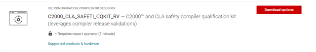

From SAFETI_CQKIT IDE, configuration, compiler or debugger | TI.com, I download
but after install, there is no compiler in it.
