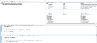

  • Hi Siva,
    Could you check if the following bit is set in the register window:
    This will confirm whether SysConfig is configuring this pin for analog mode.
    Thank you,
    Luke
  • Hello Luke,
    Thank you for your response. Within Sysconfig, the AGPIOCTRLA register has already been configured for analog mode concerning A16/C16/GPIO28. Despite using SOC4 channel to read data from A16, there's an issue; it consistently displays high data (0x0FFF). Could you kindly confirm whether the TMS320F2800157 controller supports self-triggering ADC interrupts? Additionally, I'd appreciate guidance on the appropriate SOC channel to utilize for reading data from A16.
    AGPIOCTRLA enable registers
    Regards & Thanks
    Siva Kumar
  • Hello Siva,
    Please also confirm that GpioRegs.GPAAMSEL[28] is set to 1 to enable analog mode for GPIO28. This pin is different from A4 because it is an AGPIO (meaning it has both GPIO and analog input functions). A4 is an AIO pin (analog only).
    Note that this pin is connected to the SCIA function on the LaunchPad and ControlCARD, so if you're using those boards you may want to consider a different input pin.
