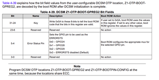

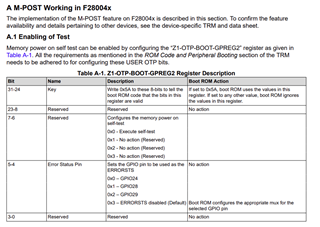

As per the document
Application Note C2000Tm Memory Power-On Self-Test (M-POST)
To enable MPOST
But in the latest technical reference manual there is no mention of the Configure the memory power on self-test register field
Is M-POST available for this device or not ?? because there is no mention of MPOST in the Technical reference manual other than a link to the document
And if the Feature is available is there any way the test execution time be reduced??
because as per the document
it takes approximately 50,000,000 INTOSC2 that is 50,000,000 * (1/10Mhz) = 5sec. which is way to much.
Can the test be executed with PLL Enabled???

    MPOST is available on this device, and the app note is correct.  I need to check to see if there was a recent update to the TRM and this was removed for some reason, by accident I assume.  I will reply back once I have some more info.
    On this device there is no way to speed up the MPOST execution, it will always operation on INTOSC2 clock.  We added ability to enable PLL with setting in GPREG2 in later devices, but this device was one of the first where we added MPOST capability.
    Matthew
  • Hi Dikshith, I apologize for any confusion here, but I looked into this matter more and it seems we intentionally removed MPOST support for F28004x primarily for the very issue you ran into, namely that the execution time is not practical and there is no way to reduce it for this device.  I will work with the team to remove C2000 Memory Power-On Self-Test (M-POST) (Rev. A) (ti.com) from the web or update it with applicable devices.  Again, many apologies for any confusion we have caused on this matter.
