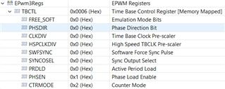

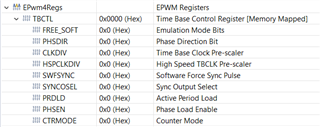

LAUNCHXL-F280049C: Problem phase shifting epwm4-8 wrt epwm1
Part Number: LAUNCHXL-F280049C
I am trying to synchronise epwm2-8  to epwm1 with each of epwm2-8 phase shifted from epwm1. The phase shift works well with epwm 1 to epwm3. From epwm 4-8, there was no phase shift even though I set this up in the code - worst enough there is a phase offset regardless of what phase shif is set for them (even at zero degree). My code is pasted below for your kind advice. In order not to bore you with annoying long script, I have limited the code to 4 modules (epwm1-4). The question now is, why are 1-3 working but 4 is not working? Result is added to show the correct phase shift between 1 and 2 (LHS). The phase offset between 1 and 4 is also added below (RHS). Two problems: (1) phase offset on epwm4-8 (2) No phase shift between epwm1 and epwm4-8 irrespective of the phase shift being set in EPwmxRegs.TBPHS.bit.TBPHS.
I understand that synchronisation works well with a maximum of three slaves per chain. I have tried looking into this by sychronisation scheme (below) in Figure 18-7 of the TRM - this is not helping me either. I think I am getting somethng wrong since the first chain is working correctly.

// Initialize ePWM modules
initEPwm1();
initEPwm2();
initEPwm3();
initEPwm4();
initEPwm5();
initEPwm6();
initEPwm7();
initEPwm8();

void initEPwm1(void) // S1 is configured on ePWM1 module
//initializeVariables();
EALLOW;
// Time Base Control Register
EPwm1Regs.TBCTL.bit.CTRMODE = TB_COUNT_UPDOWN; // Count up-down mode
EPwm1Regs.TBCTL.bit.HSPCLKDIV = TB_DIV1; // High-speed time base clock pre-scaler
EPwm1Regs.TBCTL.bit.CLKDIV = TB_DIV1; // Time base clock pre-scaler
// Time Base Period Register
EPwm1Regs.TBPRD = 2400; // Set timer period
// Counter Compare Control Register
EPwm1Regs.CMPCTL.bit.SHDWAMODE = CC_SHADOW; // Enable shadow mode for CMPA
EPwm1Regs.CMPCTL.bit.SHDWBMODE = CC_SHADOW; // Enable shadow mode for CMPB
EPwm1Regs.CMPCTL.bit.LOADAMODE = CC_CTR_ZERO; // Load when counter equals zero for CMPA
EPwm1Regs.CMPCTL.bit.LOADBMODE = CC_CTR_ZERO; // Load when counter equals zero for CMPB
// Counter Compare Registers
EPwm1Regs.CMPA.bit.CMPA = 1200; // Set compare A value
EPwm1Regs.CMPB.bit.CMPB = 1200; // Set compare B value
// Action Qualifier Control Register for EPWM1A
EPwm1Regs.AQCTLA.bit.CAU = AQ_SET; // Set PWM1A on counter up equals CMPA
EPwm1Regs.AQCTLA.bit.CAD = AQ_CLEAR; // Clear PWM1A on counter down equals CMPA
// Action Qualifier Control Register for EPWM1B
EPwm1Regs.AQCTLB.bit.CBU = AQ_SET; // Set PWM1B on counter up equals CMPB
EPwm1Regs.AQCTLB.bit.CBD = AQ_CLEAR; // Clear PWM1B on counter down equals CMPB
// Dead-Band Generator Control Register
EPwm1Regs.DBCTL.bit.OUT_MODE = DB_FULL_ENABLE; // Enable Dead-band module
EPwm1Regs.DBCTL.bit.POLSEL = DB_ACTV_HIC; // Active high complementary mode
EPwm1Regs.DBCTL.bit.IN_MODE = DBA_ALL; // Dead-band input mode
// Dead-Band Rising Edge Delay Count Register
EPwm1Regs.DBRED.bit.DBRED = DT; // Dead-band rising edge delay
// Dead-Band Falling Edge Delay Count Register
EPwm1Regs.DBFED.bit.DBFED = DT; // Dead-band falling edge delay
// Master-slave synchronization
EPwm1Regs.TBPHS.bit.TBPHS = 0; // Set Phase register to zero
EPwm1Regs.TBCTL.bit.PHSEN = TB_DISABLE; // ePWM1 is master
EPwm1Regs.TBCTL.bit.PRDLD = TB_SHADOW;
EPwm1Regs.TBCTL.bit.SYNCOSEL = TB_CTR_ZERO; // Sync down-stream module
// Interrupt when TBCTR = 0
EPwm1Regs.ETSEL.bit.INTSEL = ET_CTR_ZERO;
//EPwm1Regs.ETSEL.bit.INTSEL = ET_CTR_PRD;
EPwm1Regs.ETSEL.bit.INTEN = 1; // Enable EPWM1 INT
EPwm1Regs.ETPS.bit.INTPRD = ET_1ST; // Generate interrupt on first event
EDIS;

void initEPwm3(void) // // S3 is configured on ePWM3 module
EALLOW;
EPwm3Regs.TBCTL.bit.CTRMODE = TB_COUNT_UPDOWN; // Count up-down mode
EPwm3Regs.TBCTL.bit.HSPCLKDIV = TB_DIV1; // High-speed time base clock pre-scaler
EPwm3Regs.TBCTL.bit.CLKDIV = TB_DIV1; // Time base clock pre-scaler
EPwm3Regs.TBPRD = 2400; // Set timer period (same as ePWM1)
EPwm3Regs.CMPCTL.bit.SHDWAMODE = CC_SHADOW; // Enable shadow mode for CMPA
EPwm3Regs.CMPCTL.bit.SHDWBMODE = CC_SHADOW; // Enable shadow mode for CMPB
EPwm3Regs.CMPCTL.bit.LOADAMODE = CC_CTR_ZERO; // Load when counter equals zero for CMPA
EPwm3Regs.CMPCTL.bit.LOADBMODE = CC_CTR_ZERO; // Load when counter equals zero for CMPB
EPwm3Regs.CMPA.bit.CMPA = 1400; // Set compare A value (same as ePWM1)
EPwm3Regs.CMPB.bit.CMPB = 1400; // Set compare B value (same as ePWM1)
// Action Qualifier Control Register for EPWM3A
EPwm3Regs.AQCTLA.bit.CAU = AQ_SET; // Set PWM3A on counter up equals CMPA
EPwm3Regs.AQCTLA.bit.CAD = AQ_CLEAR; // Clear PWM3A on counter down equals CMPA
// Action Qualifier Control Register for EPWM3B
EPwm3Regs.AQCTLB.bit.CBU = AQ_SET; // Set PWM3B on counter up equals CMPB
EPwm3Regs.AQCTLB.bit.CBD = AQ_CLEAR; // Clear PWM3B on counter down equals CMPB
EPwm3Regs.DBCTL.bit.OUT_MODE = DB_FULL_ENABLE; // Enable Dead-band module
EPwm3Regs.DBCTL.bit.POLSEL = DB_ACTV_HIC; // Active high complementary mode
EPwm3Regs.DBCTL.bit.IN_MODE = DBA_ALL; // Dead-band input mode
EPwm3Regs.DBRED.bit.DBRED = DT; // Dead-band rising edge delay
EPwm3Regs.DBFED.bit.DBFED = DT; // Dead-band falling edge delay
// Slave synchronization to ePWM1
EPwm3Regs.TBCTL.bit.PHSEN = TB_ENABLE; // ePWM3 is synchronized to ePWM1
EPwm3Regs.TBCTL.bit.PHSDIR = TB_DOWN;
EPwm3Regs.TBPHS.bit.TBPHS = 2200; // Phase is shift
EPwm3Regs.TBCTL.bit.SYNCOSEL = TB_SYNC_IN; // sync flow-through
// EPwm3Regs.ETSEL.bit.INTSEL = ET_CTR_ZERO;
//// EPwm1Regs.ETSEL.bit.INTSEL = ET_CTR_PRD;
// EPwm3Regs.ETSEL.bit.INTEN = 1; // Enable EPWM1 INT
// EPwm3Regs.ETPS.bit.INTPRD = ET_1ST; // Generate interrupt on first event
EDIS;
void initEPwm4(void) // S4 is configured on ePWM4 module
EPwm4Regs.TBCTL.bit.PHSEN = TB_ENABLE; // ePWM4 is synchronized to ePWM1
EPwm4Regs.TBCTL.bit.PHSDIR = TB_DOWN;
EPwm4Regs.TBPHS.bit.TBPHS = 2250; // Phase shift from ePWM1
EPwm4Regs.TBCTL.bit.SYNCOSEL = TB_SYNC_IN; // sync flow-through
