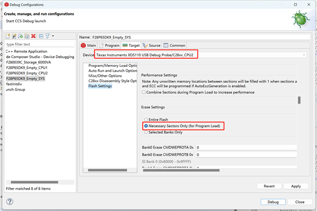

A few threads have discussed the issue of debug not working in CSS when working with LAUNCHXL-F28P65X
Getting this error.  Program will load and execute but will not enter debug in CSS
28xx_CPU2: Flash Programmer: Error erasing Bank 0 FMSTAT (STATCMD on some devices) value = 65. Operation Cancelled (0).
C28xx_CPU2: File Loader: Memory write failed: Unknown error
C28xx_CPU2: GEL: File: C:\Users\xxxxxxxxxx\workspace_v12\launchxl_ex1_f28p65x_demo\CPU1_LAUNCHXL_FLASH\launchxl_ex1_f28p65x_demo.out: Load failed.
Any help appreciated.
  • If you want to load the code for two CPUs at once during debugging, you need to insert a code after CPU1 completes memory allocation to CPU2. And make some changes to the debug configuration:
    void CPU2_Debug_Load_Symbol();
    void main(void)
        Device_init();                                      // Initialize device clock and peripherals
        Device_initGPIO();                                  // Disable pin locks and enable internal pull-ups.
        Interrupt_initModule();                             // Initialize PIE and clear PIE registers. Disables CPU interrupts.
        Interrupt_initVectorTable();                        // Initialize the PIE vector table with pointers to the shell Interrupt
        Board_init();                                       // PinMux and Peripheral Initialization
        Device_bootCPU2(BOOT_MODE_CPU2);                    // Boot CPU2 core
        IPC_sync(IPC_CPU1_L_CPU2_R, IPC_Start);
        EINT;
        ERTM;
        while(1)
        NOP;
  • Thanks!  This worked
