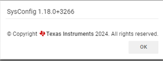

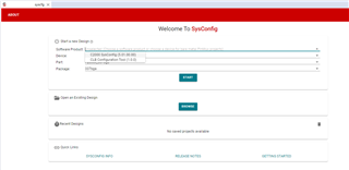

I am trying to create an empty CLB project for the 388.  I downloaded the latest SysConfig tool, and started it.  I was able to create the first little bit of configuration in the CLB tool, and saved it to a file.  That file is in an empty CCS project.  It has a main file and the syscfg file.  When I try to open the syscfg file from CCS, it is unable to do so, and gives me the dialog box below.  Since I am able to restart SysConfig and re-open the syscfg file, there must be something which I need to do to the project to allow CCS to open it too.  But looking at the properties for the file, I can find anything.  Where should I be looking?
Thank you,
Ed
  • Hi Ed,
    What version of CCS did you install? What version of the Stand alone SysConfig Tool did you download?
    Ryan Ma
  • Hi Ryan,
    I am using:
    CCS 12.5.0.00007
    SysConfig 1.20.0+3587
     Ed

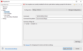

  • As an additional clue, when I click the back button, I get the following.  The part which is covered up is Device: F2838x and Part: F2838x_377bga.  The thing which jumped out at me is the CLB Configuration Tool (1.0.0).  It seems that I need to do something to get CCS to recognize the newer tool.
    Ed

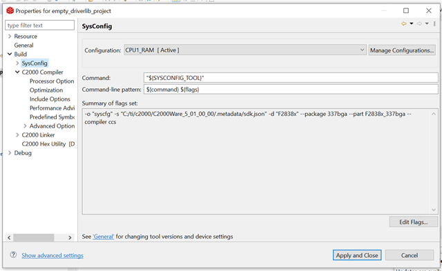

  • Hi Ed,
    Can you share your .syscfg file as well as your SysConfig settings in your project properties? You should see a .metadata/sdk.json file in your project properties linking the SysConfig executable to C2000Ware.

  • I tried that, and received the following:
    When I click ABOUT, I receive the following:
    Ed
  • Can you send a screenshot of the following fields in your project properties?
  • OK.  I think we are getting somewhere.  My project files must be wrong.  When I look at them, I see CM stuff in them.  And that seems to have resulted in the project thinking it is a CM project.  I get an error when I try to open the project properties.  When I click OK, the properties show it to be a CM project.  The SysConfig folder can be opened, but the Basic Options cannot be accessed.  Looking at the .ccsproject file, I see the line below.  So I think I started with the wrong template project.  How should I have started it?
                    <templateProperties value="id=com.ti.common.project.core.emptyProjectWithMainTemplate"/>
    Thank you,
    Ed
  • Hi Ed,
    I'd try importing an empty project from C2000Ware/driverlib/f2838x/examples/c28x/empty_projects
    Thank you,
    Luke
  • That worked.  I am able to open and modify the syscfg file.
    Thank you for your help Luke.
