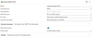

  • I am finally able to to use the SCI to control the GPIO but the output goes 'High' on its own for a brief time even after the following declaration:
    Board_init();
    GPIO_writePin(myBoardLED0_GPIO1,0);  // try resetting asap
    more specficially, observing using breakpoints- in the board_init function in the board.c file, it sets the output 'high' after
    GPIO_setDirectionMode(myBoardLED0_GPIO1, GPIO_DIR_MODE_OUT);
    I am using the LaunchPad-XL 280025C fyi
  • Hi Advit,
    This Board_init() function is automatically generated from the SysConfig code generation tool. You can see what this function does by looking at the Generated Files in the project, or looking into the .syscfg file. This SysConfig getting started video is a good quick resource if you are new to it to see how this works in the project: https://www.ti.com/video/6304748751001. I believe you can also find the source code for any function call in your program by pressing the CTRL button and clicking on any function call.
    Are you using the SysConfig GUI? If so, can you please share what settings you have there? In SysConfig, you should be able to set the GPIO as an output and program an initial value (in this case, 0). Are you already doing this?
    Allison
  • Yes I am already doing this.  I also tried the push-pull pin type to no luck
  • Hi Advit,
    I believe these should default low, so that's strange. Can you share a screen capture of the board.c file? And also run a debug session where you monitor the GPIO registers (e.g. GPIO DAT regs) in the 'Registers' window of CCS and then step into the board_init() function and step over the code to watch where that GPIO's settings change and where the GPIO becomes high? This can narrow down which function is generating the high state.
    Allison
  • Hi Allison,
    I have attached a screenshot of the board.c file. During the debug session, the GPIO becomes HIGH after _setDirectionMode command (highlighted) in the board.c file. I have a separate LED thats doing the same even after giving a inital low value.
    AVDIT
  • Hi Advit,
    When you monitor the GPxDAT register of those GPIOs (with continuous refresh on) and step through the code, do you see the reg value become 1 at all? Can you also "step into" the GPIO_setDirectionMode() and step over each line to see precisely where the register value/output change?
    Allison
  • I think since the led is inherently pulled up to VCC on the PCB setting the initial value as 0 lights up the LED. Bu now I am confused if my SCI generate pulse is working.

  • Hi Avdit,
    I just checked and specifically the LED's are actually active low on the controlcards and launchpads, so initializing the GPIO to 1 instead of 0 is correct!
