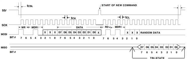

I'm trying to get LS7366R iC's register value through SPI however, I have some problems with it and I need some help please cause I couldn't solve these problems for about 3 weeks ...
This is the SPI protocol diagram that I want to make between LS7366R(SPI slave) and TMS320F28388D(SPI master).
(This is the diagram from LS7366R datasheet. LS7366R datasheet link : https://lsicsi.com/datasheets/LS7366R.pdf
So I set my sysconfig settings, wrote the code, and connected the SPI lines to oscilloscope. These pictures are my sysconfig settings, codes, and oscilloscope signal screenshots.

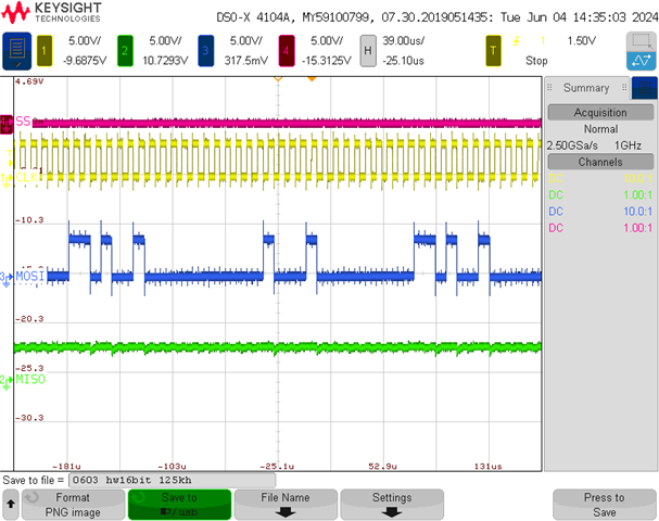

CLK should only work when STE == LOW, CLK also works when STE == HIGH.
If you look at the logic of the main code, there is absolutely no reason for CLK to work because it raises STE to HIGH after the data transmit, but I don't know why it's like this.
Looking at the oscilloscope waveform, SPI_writeDataBlockingNonFIFO and STE seem to operate independently.
Is this because of the operation of STE with GPIO? I don't know why...

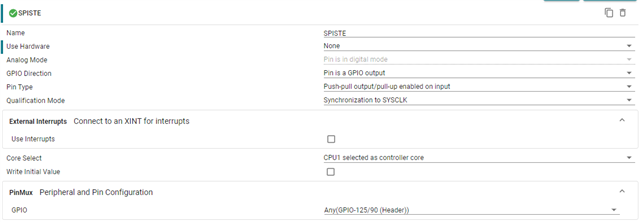

In order to solve the problem of not working when the data transfer function is in the STE==LOW state, DEVICE_DELAY_US (200) was arbitrarily given between SPI_writeDataBlockingNonFIFO and STE_HIGH, and the following waveform was taken.
At this time, when looking at the STE(=SS) waveform, the LOW state is maintained exactly about 200us.
So, I wrote it in order on the code, but do GPIO and SPI move independently? How should I look at this phenomenon?
And if this is a problem caused by controlling with GPIO, how should I set it up in the SPI of sysconfig to send two 8bit data in a row?

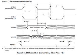

  • Hi Sumin,
    It is indeed strange that the protocol is operating when the CS is high and might have something to do with the manual timing of the CS when using GPIOs. As a starting point, in addition to other E2Es that discuss using a GPIO as SPI, you can refer to this F2838x example that communicates with an EEPROM and controls the CS manually (C2000Ware_5_02_00_00\driverlib\f2838x\examples\c28x\spi\spi_ex6_eeprom.syscfg). Let me know if this serves to be helpful.
    Is there a specific reason you are using this GPIO implementation? If not, I would recommend using the SPIPTE pin and let the hardware takes care of the CS.

  • Sumin,
    And I'm using the GPIO because I need to send 2 8bit data in a row. But I could not send the data in a row when I put the CS in hardware mode.
    Referring to C2000 SPI as well as the other SPI, it is shown that after every SPI transmission (8-16 bits), there is at least one clock cycle before the next transmission. If I am understanding correctly, you can configure the SPI to send 2 8-bits of data at a time and the hardware will take care of it going high and low accordingly. This can be put in a function that is called repeatedly. Right now, it looks like two 8-bit data are sent without taking into account the SPI rise time, hold time, setup time, etc. This information is in the datasheet and should be used to add delays which is a good approach.
    In addition, I am not sure if this will help as I haven't tested it, but have you considered setting TxData outside of the while loop since the data stays constant?
    Aishwarya

    If you look at the signal, MISO seems like it works as ACTIVE LOW, however, the default state of MISO has to be LOW.
    So I'm wondering,
    1) Why MISO acts like that?
    2) In the code I only used the SPI WRITE function. However, the SPI READ function was also activated because the MISO signal reacted. How can this be explained?
    Also, there were some other curious outputs that I couldn't understand.
    In the code above, I tried changing the DEVICE_DELAY_US() values. When I set the delay time short, the CS pin did not act although I used the API function.
    The signal picture is below.
    I strongly think that SPICLK is somehow related to this 'delay time', but I can't guess 'what kind of relationship' there is.
    I also tried resetting the SPI TX BUFFER at the end of the loop because I thought that it might effect on the next loop's action.
    So I wrote HWREGH(mySPI0_BASE + SPI_O_TXBUF) = 0; and the result was like the picture below.
    All I did was clearing the TX BUFFER, but the CLK acted 32 TIMES.
    How should I explain this situation? I can't analyze this result.
    PLEASE HELP ME ....

    And the result was a success!!!!!
    I got the signal shape shown in the picture below.
    I'm guessing that the reason I failed with my previous code was that I wasn't using FIFO.
    In non FIFO mode only one data transmission can be done because it only handles one data in one call of the function.
    Thank you so much for your comments. It helped me very much:)
