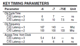

ISSI IS42S32160F meets my requirements. But it has 133MHz, 143MHz and 167MHz frequencies.
TMS32028388D mcu EMIF frequency is 100MHz.
1) In this case, can I use this SDRAM with 100MHz or can I only use it with 133, 143, 167MHz options?

  • 1) In this case, can I use this SDRAM with 100MHz or can I only use it with 133, 143, 167MHz options?
    You can use any one of them. The frequency of the SDRAM should be >= EMIF_CLK
    2) How to choose EMIF compliant SDRAM? What should be considered?
    EMIF_CLK is configurable for meeting the timing requirements in the SDRAM. Check if EMIF supports the bank number of SDRAM, CAS latency, # of column address, and # of row address.
