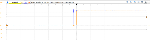

I did a first test of CMPSS with OUTPUT XBAR to link OUTH to a GPIO
The input of the CMPSS is a manual potentiometer, the negative input source is the internal DAC.
I am surprised to see the shape of the GPIO I connect OUTH to.
I tested id with the hysteris option X2:
Is the slope I can see on the first graph due to the bounces on OUTH, filtered by the the type of OUTPUT X BAR ?
By the way, what is this type ? Push Pull only?

    I am using the cmpss_ex1_asynch example which does this same thing. I am setting hysteresis to zero and I am unable to see your resulting waveform:
    My inputs to CMPSS were a GPIO and the DAC. I suspect that your waveform is caused by the nature of your input which changes relatively slowly. For this reason, it makes sense to use hysteresis to avoid the output bounce.

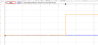

  • Could you test this to make sure?
    Of course: see the blue curve (orange one is only to trigger the oscilloscope)
    With potentiometer without hysteresis:
    with GPIO:
    With zoom:
    The transition of the output is about 10ns
