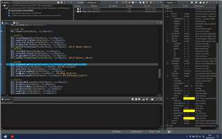

1) In line 33, flaming or parity error flags (SCIRXBUF.SCIFFFE, SCIRXBUF.SCIFFPE) are set 1 when enabling TXFIFO.
We don't expect this before enabling RX. At this time, RXFIFO is empty and no RX errors. (SCIFFRX.RXFFST=0, SCIRXST.RXERROR=0)
2) In line 41, An RXFIFO interrupt flag (SCIFFRX.RXFFINT) is set 1 when setting the RXFIFO interrupt level.
Also it confuses us why it is set 1 even though FIFO is empty.

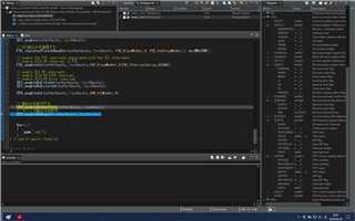

3) In line 89, an SCI reception interrupt occurs after enabling interrupts.
4) RXERROR is set to 1 in the SCI reception interrupt, and MCU no longer receives any data to determine as a reception error and discard continuously.

in line 33.
in line 41.
in line 89.
