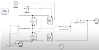

I have a DC-to-AC converter that runs successfully in MATLAB Simulink 2024a. Now I want to use the TI F280049C microcontroller in the circuit. I want to control the invertor with F280049C.
How does the TI F280049C microcontroller PWM interact with my DC-to-AC inverter MOSFET? then I will generate the code.

    From a hardware standpoint, you would need a gate driver between the the C2000 PWM and the MOSFET. Not certain if that's your question.

    Thank you for your reply. To be more specific, from the uploaded DC-to-AC circuit above, I need to replace the pulse generator with the C2000 PWM to drive the MOSFET. I tried to use the ePWM of F2800x from the Simulink library, but I did not understand how the Simulink ePWM connected with the MOSFET.
    I use only Simulink 2024a and TI F280049C microcontroller.

    If you are trying to use F280049C from C2000 microcontroller block set with Simulink Embedded Coder, then please note that it can be only used to generates c-code project that can be loaded in F280049C using CCS tool chain. Please note that it can not be used in simulation environment.
