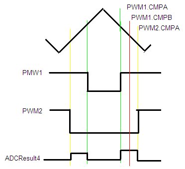

  • I would also like to mention one thing around the ADC conversion.
    When i look at the AdcResult.ADCRESULT4 in CCS watch window, which has a bias point around 2048, the number keeps on dropping down and back to the bias point  when current is running in the motor phase. Ideally the ADCRESULT4 should always show 2048 - measured_current, without jumping back and forth ( constant without much variation during a given current ).
    Im thinking this could also be some issue with ADC configuration?
  • Pavel,
    I am confused on what you mean with ADCRESULT4 should always show 2048. ADCRESULT4 is measuring the current draw seen by the motor, so when the motor is running this number will jump back and forth from the bias point, but ADCRESULT4 should be set to sample the peak amount being drawn. The ADC configuration should be set up as seen in the graph below.
    LT
  • Hi Thomas,
    The problem i had for controlling very low currents, was due to that i was measuring a very weak analog signal with a lot of noise. So my sampled signal had a low of unwanted information (that was when measuring with U13 opamp, I-Total signal). The I-TOTAL signal also had information of the difference between two of the Rsense voltages, and that made it even more difficult, where sampling time had to be very accurate.
    Therefore i changed my strategy by sensing at different sense resistors, dependent on the commutation State i was (using the two current opamps in the DRV8301). By doing this the analog signal was much more pure, and not as distorted as the I-Total (by knowing what Rsense to measure at a given State). This solved my problem and now I'am able to regulate very low current (<100mA) in the motor phase.
