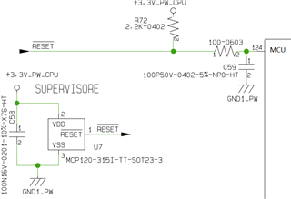

    The circuit of the XRS pin is the following:
    We captured the POR during the surge pulse after the removal of 100 ohm resistor in the diagram above: from this test we understood that the supervisor is not triggering any undervoltage on 3.3V rail.
    - Yellow trace: MCP120 output voltage (nRESET line in the schematic)
    - Red trace: nXRS MCU (pin 124)
    It doesn't seem related to 3,3V rail undervoltage because otherwise we would have seen it in the yellow trace above. Could it otherwise be a radiated disturbance coupled internally in the MCU? Which is your sopposed fault mode?
    Thank you for your reply.
    Giacomo
  • Hi Giacomo, unfortunately Ben is OOO this week.  He should be able to get back to you early next week.  I appreciate your patience and apologize for any inconvenience.
  • Can you run the same test again but leave 100 Ohm in circuit as that removed pull up resistor (R72) from +3v3 rail. What is value of C59? Seems like 100pF? There is a specification in the TRM for required C value, typically 100nF other C2000 MCU classes.

    about the capacitor value: we already tried with C59=100nF and R72=1kohm but the problem remains.
    About the new suggested test: we removed R72 and the supervisor MPC120 and we mounted C59=100nF. The result is the following:
      - the yellow trace is the +3.3V_PW_CPU voltage during the surge event; you will see an oscillation around the 3.3V value; the measure has been conducted trying to close the measuring loop as best as possible but we cannot exclude a residual contribution due to irradiated pickup noise; we cannot see an important undervoltage below the POR reset threshold during the event.
     - the red trace is the nXRS pin voltage;
