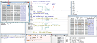

i am trying to inject e.g. ECC error into RAM and then read the same adress to check the reaction, e.g. Interrupt should be triggered.
But when i flip the bits at the specific address, with Debugger memory display (lauterbach) i dont see the content change at the address. Finally i can see the interrupt is triggered, i just dont know why the debugger does not show the manipulated content at the address?
I find this in the TRM: what does it mean?
