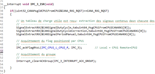

When CPU1 send a message to CPU2, I set an IPC  (SET register thanks to IPC_setFlagLtoR function) Flag which generates an interrupt for CPU2. In the ISR, I acknowldge this Flag in its STS Register by setting the corresponding bit in the ACK Register (IPC_ackFlagRtoL function). The CPU1 waits for this acknowledgment polling its FLAG Register (IPC_waitForAck function)

I checked with the debugger:
- the code runs into the ISR IPC_3
- the code runs into the function IPC_ackFlagRtoL(IPC_CPU1_L_CPU2_R, IPC_3)
- The code never goes out from the function IPC_waitForAck(IPC_CPU2_L_CPU1_R,CPU2_to_CPU1_IPC_FLAG3);

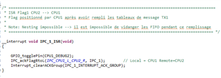

  • Hello Benjamin,
    I did some tests that can help you.
    I reproduced the issue on the LED blinking example (see the attached archive)
    In the CPU2 main loop, I only inserted the set of the IPC Flag:
    With FLAG1, everything is fine: CPU1 acknowledges the Flag in the ISR
    With FLAG3, the red LED stops blinking because the code never goes out from the WaitForACK loop:
    Could you look at the archive I joint ? (it does not contains any application code, just TI example + IPC)
