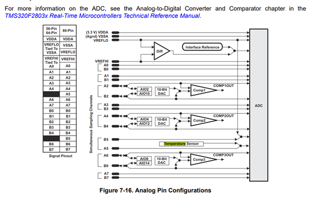

TMS320F28035: Does F28035PAG(64 PIN) has on chip temperature sensor?
Part Number: TMS320F28035
Hi Team,
From below picture, It means that F28035PAG don't have on chip temperature sensor?(64 PIN don't have A5)
But from the customer's test, some chips can read right temperature, but some chips can't.
Here is the configuration from customer, and they use external refer voltage 3V:
    AdcRegs.ADCCTL1.bit.ADCBGPWD  = 1;      // Power ADC BG
    AdcRegs.ADCCTL1.bit.ADCREFPWD = 1;      // Power reference
    AdcRegs.ADCCTL1.bit.ADCPWDN   = 1;      // Power ADC
    AdcRegs.ADCCTL1.bit.ADCENABLE = 1;      // Enable ADC
    AdcRegs.ADCCTL1.bit.ADCREFSEL = 1;      // Select external BG
    AdcRegs.ADCSOC14CTL.bit.TRIGSEL = EPWM5_ADCSOCA;
    AdcRegs.ADCCTL1.bit.TEMPCONV = 1; //Connect A5 - temp sensor
    AdcRegs.ADCSOC14CTL.bit.CHSEL = 0x05; //Set SOC0 to sample A5
    AdcRegs.ADCSOC14CTL.bit.ACQPS = ADC_SHCLK;
  0℃ offset = 1750 * (3.3 / 3.0) = 1925 LSBs
  slope = 5.56 * (3.3 / 3.0) = 6.12 LSBs
  that is: 1 / 6.12 = 0.16 °C/LSB
Zane
  • Zane,
    The temperature sensor is there, even if the ADCINA5 pin does not come to the package.  Please have the customer use the temperature sensor example in C2000 ware here: C:\ti\c2000\C2000Ware_5_02_00_00\device_support\f2803x\examples\c28\adc_temp_sensor_conv   as this will ensure the correct settings for sampling the temp sensor on the device.
    Let me know if above cleans things up for the customer.
    Matthew
