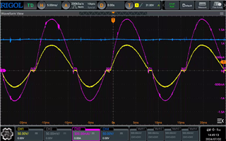

My team is working on the TIDA-01604 reference design. We have tested all the builds and everything works correctly. For our product, we need bidirectional power conversion, so we are now using the TIDM-2008 code reference design for validation. Labs 5 to 7 worked perfectly. However, our problems start with Lab 8. After following the steps in the design guide, we obtain the following waveforms:
- Purple: Current
- Yellow: Voltage
- Blue: VBUS
¿What could be happening?
Thanks!
Pablo
