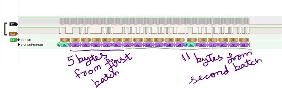

I need to send 27 bytes to the SSD1306 display device for initializing it via I2C.
When I try to send only the first 16 characters to the I2C slave, i get the required data on the I2C bus. I verified it using the logic analyser :
first 16 bytes, i2c
When I try to send the 27 characters in two batches, 16+11, I get only the last 16 bytes in the I2C bus, 5 from the first batch and 11 from the second batch. Logic analyser output:
I have pasted the relevant i2c function code below.
It would be helpful if some one can point out what I am doing wrong :

  • Hi Balaji,
    It looks the data is being overwritten in the I2C buffers. You can verify this by checking what the data is in both the buffers and on the data line itself between the first 16 bytes and the second 11 bytes which should show you if the first 16 bytes are transmitted / received properly. As for the data you have not labelled in the second image, is this data from the first transmission and/or some other known values or are they random? Are the interrupts being triggered / working correctly? When the I2C is in FIFO mode, the I2CCNT is not used but rather the TXFFST.
    I2C buffers need to be cleared before more data is written / read from and this information is in the TRM as well as software examples itself in more detail. Please precisely identify where the issue occurs in software and the steps taken for resolution, so I can better assist.
    Aishwarya
  • I could get the code working following the examples you have mentioned. The code that is sending the full 27 bytes is pasted below.
    The statement
        while(I2C_getTxFIFOStatus(I2CA_BASE)!=I2C_FIFO_TX0){}//Wait till FIFO remaining bits is zero?
    ensures that the transmit FIFO gets empty before going for the next 11 bytes.
    By the way, simply putting a delay of 100ms after the the I2C_sendStartCondition() function call , before the
     I2C_sendStopCondition() also works...
