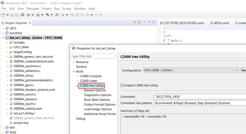

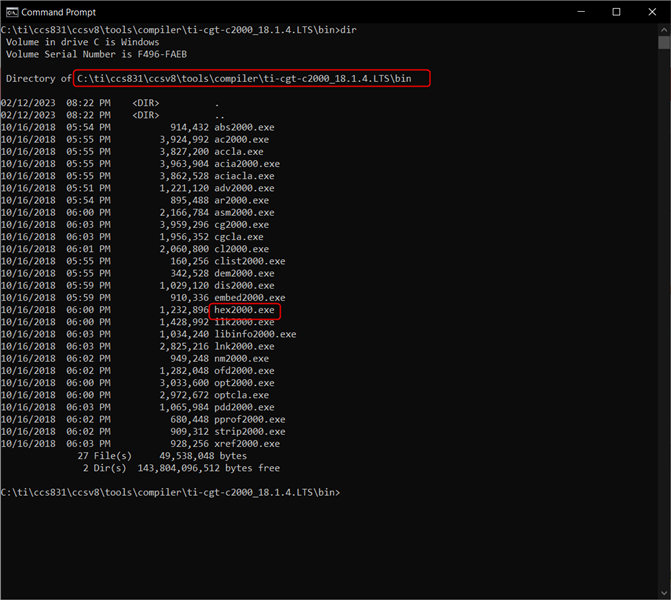

    The C2000 Hex Utility comes with the compiler that ships with CCS 8.3.1:
    and project property GUI integration is also available:
    Can the customer explain what they mean by that there is no C2000 Hex Utility?
