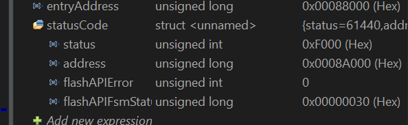

  • Hi Charles,
    I have made all the necessary changes and am able to receive the test frames. I also flashed the application, but it is not returning after receiving the last frames.
    I monitored the expressions and can see that all the frames are being received.
    I have attached the code and a screenshot for your reference.

    After sending all the frames I pause the execution its running SPINS FOREVER.
    Hariprasath.
  • Hi Hari,
    When sending the application are you sending it with 128bit or 512-bit programming based on the previous example?
    Charles
  • Hi Charles,
    I am programming 8 words at once, 128-bits

  • Hi Charles,
    The 128-programming section is Failing
    Attached flash_kernel_boot.c for ref

                                       oReturnCheck = Fapi_issueAsyncCommandWithAddress(
                                               Fapi_EraseSector, (uint32_t *) sectorAddress);
                                       while (Fapi_checkFsmForReady() != Fapi_Status_FsmReady){}
                                       oFlashStatus = Fapi_getFsmStatus();
                                       oReturnCheck = Fapi_doBlankCheck(
                                               (uint32_t *) sectorAddress, sectorSize,
                                               &oFlashStatusWord);
                                       if (oReturnCheck != Fapi_Status_Success || oFlashStatus != 0)
                                           if (fail == 0)
                                                  statusCode.status = BLANK_ERROR;
                                                  statusCode.address =
                                                          oFlashStatusWord.au32StatusWord[0];
                                                  setFlashAPIError(oReturnCheck);
                                                  statusCode.flashAPIFsmStatus = oFlashStatus;
                                          fail++;
                                          GPIO_writePin(31, 1);

    Hariprasath.
  • Hi Hari,
    Based on your screenshot of the FsmStatus, it looks like the flash kernel is trying to re-program a location of flash memory that hasn't been erased yet. See table 8 of the Flash API guide to see what each bit of FMSTAT represents.
    Additionally, based on the linker files you have sent it looks like you are trying to load and run the flash kernel in flash. By default, the flash kernel examples execute from RAM. If you would like to keep the flash kernel in flash, that is fine, but you have to run all flash API functions (and functions that call the flash API) from RAM.  The .TI.ramfunc section of the linker cmd file should have a flash-based Load address and a RAM-based Run address. Refer to 28002x_generic_flash_lnk.cmd in C2000Ware for an example (C2000Ware_5_02_00_00\device_support\f28002x\common\cmd)
    Kind regards,
    Skyler
  • Hi Skyler,
    When Iam trying with the 28002x_generic_flash_lnk.cmd the program I am getting stuck in "No source available for SysCtl_delay() "
    Attached screenshot for ref .

  • Hi Hari,
    Where is the flash kernel execution does this occur?
    Kind regards,
    Skyler
  • Hi Skyler,
    In the sysctl_setClock function its happening.
    I can't be able to find the reason.
    Hariprasath.
  • Hi Hari,
    Is _FLASH defined in your project? If not, functions given a RAM-based run-address won't be copied from flash to RAM during initialization.
    Kind regards,
    Skyler
  • Hi Skyler,
    Now that issue is cleared while Iam calling set active flash function its running out of the program.
    Attached the screenshot for your reference.
    The Initialization getting success but Active flash banks getting failed, what can be the issue?
    Attached the cmd file for ref.

    Hari
  • Hi Hari,
    When calling the Flash_InitModule() function, what wait state value are you passing?
    Kind regards,
    Skyler
  • Hi Skyer,
    I am setting value 4 for the wait state.
    Hari
  • Hi Hari,
    The default flash wait state value for the F28003x device is 5. Do you wish to operate the Flash initialization at a different clock rate?
    Charles
  • Hi Charles,
    The Wait state value for 100MHZ is 4, so I took that.
    Hariprasath.
  • Hari,
    Thank you for the correction (was comparing to the F28003x device header).
    Does the Fapi_setActiveFlashBank function reside in RAM when called upon? For this you can check your generated  .map file for the address where this function is being placed?
    Another thing to try is RAM LS4567 region to accommodate the Flash API, and to group together the functions for .TI.ramfunc. For F28002x device, you can refer to the flashapi_ex1_programming project's 28002x_flash_api_lnk.cmd file.
    Charles
  • Hi Charles,
    I made those changes, and the Fapi_setActiveFlashBank function was successful. However, I'm encountering a flash error during the flashing process.
    I also noticed something else: while flashing, I’m getting an error at the 0x8C000 address. The application wrote one frame in memory, which I verified using Uniflash.
    Hari
  • When the one frame is written, are you able to verify if any other frames are coming into the RX/TX message buffer on the device side?
  • Hi Charles,
    Yes, It's updating in the RX buffer till the last frame of application.
    Hari.
  • Hi Charles,
    And I noticed something else while Iam using the buffer size 8 I can able to write everything in flash memory except start sector address. [used unifialsh  to verify the flash memory]
    from the text to the constantan's and wrote.

    What is being written at 0x8C000? Based on the linker files, there isn't anything being stored in Bank 0 Sector 12 (starts at 0x8C000).
    Is 0x8C000 the sector start address you are referring to here?

  • Hi Skyler,
    Bank 0, Sector 4 is my start address for the application.
    At address 0x84000, the value is 0xFFFF.
    Hariprasath
  • Hi Skyler,
    Now I Resolved that issue Now everything is flashed on the locations, however while returning Entry point system runs in forever loop.
    Hariprasath.

    It's failing at the address of ISR1 Ram func while writing.
    Hariprasath
  • Hi Skyler,
    In the map file [ wherever the ISR1 is there its failing on that address while writing], What can be the issue?
    ramfuncs 0 0000065e 0000017d
    0000065e 0000017d sys_main.obj (ramfuncs:ISR1)
    Hariprasath.
  • Hari,
    In the linker cmd file you have ramfuncs as a part of the other funcs grouping (aside from controlfuncs), is this ISR intended to reside in RAM or Flash? The page is 0, origin is 0000065e, and length is 0000017d correct? Is the buffer length still 0x8 that you have set above?
    Charles
