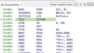

  • Dear Wang:
    I may have already solved the problem, but for some reason, I changed the CMD file, refreshed the CMD file, and placed some RAMGS into Page1. This allowed me to read the data at 0x380000, but some problems occurred. When executing InitFlash(), an ESTOP occurs, which didn't happen with the previous CMD file, but does occur after the modification.
    #if FLASH
    MemCopy(&RamfuncsLoadStart, &RamfuncsLoadEnd, &RamfuncsRunStart);
    MemCopy(&Flash021_API_LoadStart, &Flash021_API_LoadEnd, &Flash021_API_RunStart);
    InitFlash();
    #endif
    attach file CMD file

    The load address and start address in your InitFlash() doesn't match the names defined in cmd file:
