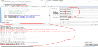

The program assigns BANK3 and BANK4 to CPU2 and the others to CPU1But in practice, only the program that assigns all BANK0-4 to the corresponding CPU1/2 can be burned into it, otherwise the burning will fail
The above is a screenshot of successful burning after assigning all five banks to CPU2. The error is caused by accidentally pressing the reset key

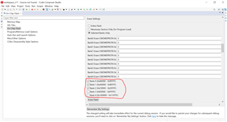

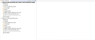

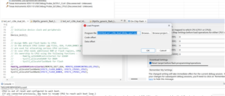

    Ok, I'm going to show each of my operations。First, I compiled the routines of CPU1 and CPU2 into versions that could be burned to flash

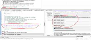

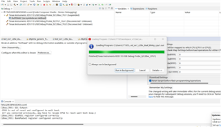

    Then, I connected to CPU1, and then burned the corresponding.out file to cpu1. Now I assigned all BANK0-BANK4 to CPU1, and the burning succeeded
    According to the program, I should assign BANK3 and BANK4 to CPU2. Only when I assign all BANK0 to 4 to CPU1, CPU1 can be burned successfully, and you can see that CPU1 can run。

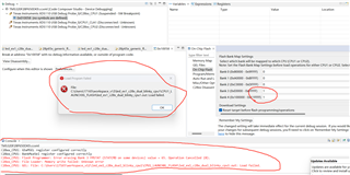

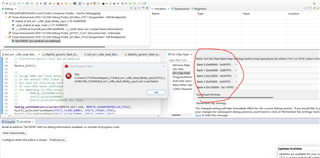

    When I assigned BANK3 and BANK4 to CPU2 as in the program, burning failed.
    Error erasing Bank 3 FMSTAT (STATCMD on some devices) value = 65.0 peration Cancelled (0).
    All banks are assigned to CPU1, and the burning is successful again

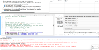

    On the basis of the successful burning of all banks assigned to CPU1, I start to burn the program of CPU2
    Unfortunately, CPU2 cannot be burned successfully. I have assigned BANK0-4 to CPU1 in the form of permutation and combination, but the burning cannot succeed. Only when all BANK0-4 are assigned to CPU1 or CPU2, the burning can succeed

  • There are two things I should add:1. I used the official routines and didn't make any changes to them other than compiling them into.out files that can be burned to Flash. 2.I can only assign BANK0-BANK4 in On-Chip Flash when I burn the program to CPU1
     Lux
  • Hi Lux,

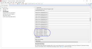

    On the burning for CPU1 (and CPU2), did you set the erase boxes in the On-Chip Flash tool? For example:
    CPU 1 target's Bank 3 and Bank 4 erase boxes should be unselected.
    CPU 2 target's Bank 3 and Bank 4 erase boxes should be selected.

  • Hi ,
    According to your tips, I found the reason why I could not burn successfully. Now CPU1 and CPU2 have been running. Thank you for your help.
    I would like to know if there are any manual instructions on the specific steps of program burning or debugging. Because the manual provided by the evaluation version of LANUNCHXL-F28P65X does not mention how to burn, I did not configure this step you mentioned. If there is such a manual, could you please provide me with one? Thank you very much!
