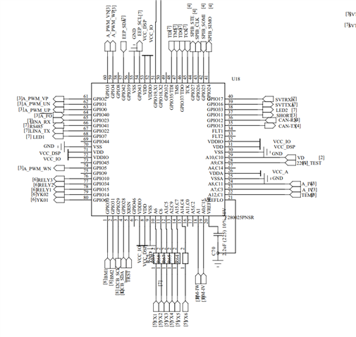

My customer encountered a situation where the chip did not work after powering on the 280025PNSR during production. The program was able to download normally, but it did not work. The measured voltage of the chip's 3.3V power supply pin was normal, and the 1.2V power supply pin was also normal. The waveform of the reset pin is shown in Figure 2. The reset delay is due to the addition of the SP809-2.9 chip, which delayed the reset by 230ms. Please help provide some suggestions for troubleshooting the abnormality. Currently, the customer has not changed the hardware and software, and some are working normally while others are abnormal
yellow is VCC_IO ;  Green is XRSN;  Blue is VCC_DSP

  • XRSn pin on the F28002x device is an open drain type driver(Bi-directional), so we need to connect both it and the SP809 to a external PU that will allow either to drive/release the signal.  When you remove R108 you are seeing the internal POR/BOR logic control reset exclusively, If SP809 is connected directly to the XRSn pin w/o external PU then there there will be excess current sink to our device, which may be impacting the power up.  We use a 2.2kOhm PU on our reference designs, this should work here as well.
    Also, we need to make sure the boot pins GPIO24 and GPIO32 are properly driven during boot up, which includes some time after XRSn is released(the boot ROM will sample the values on these pins to determine the boot mode).

  • Amos,
    The connection from SP809 to the F28002x cannot be direct, there must be a common PU connection point since XRSn is a bi-directional pin from our device.  Looking back at the schematic I see there is a 4.7k PU on this net, so I'm not entirely sure why SP809 is causing an issue.  230ms is a very long time to hold off reset signal, but it should not matter.
    Can you confirm the state of the boot pins, GPIO32/24 when XRSn goes high?  For boot to flash both these pins needs to be pulled high so the boot ROM enters the correct boot mode.  I see that GPIO24 is connected to a SPI, but GPIO32 does not connect on the image you have shown.  If these pins are not pulled up, the device could enter a different boot mode when XRSn is released.
    To you Q1, the F28002x has a built in POR/BOR logic that will hold XRSn until 3.3V rail within a certain range specified by the DS.  This should function as the supervisor, so that is why when you remove R108 you still see the device working correctly.
    As the 3.3V rail comes active there will be some transition point where the XRSn will release, the POR will get a fine trim from the eFUSE on the device, and then go back into Reset until the VDDIO reaches the final threshold.  No code will execute during this period so things should be OK from a system POV(this is why you see XRSn go high for a small amount of time then go back low before coming up high finally).
    For Q2, the device is rated to 125C, so 60C should not be an issue.  Do you know what the failure mode was for the 8 devices?  XRSn de-assert but device doesn't begin functional code or something else?  Was the device fully powered down before powering back up and XRSn goes low, etc?
    Matthew

  • The current design is that GPIO24 is connected to SPI,GPIO32 does not have any connection, whether there is a weak pull up inside.
    As for the design of this, the R108 is removed, and from the current test (100 sets, continuous power on and off, can work normally), it can work normally. In this way, whether to release, flow to the customer?

  • Amos,
    It should be OK to rely on the internal POR/BOR to gate reset.  I would advise to see if longer term you can put a pull up on GPIO32, even though there is a weak pullup we recommend to place a stronger one outside to hold the pin.
