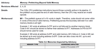

Part Number: TMS320F2800157
in the following Errata,
I want to confirm that this Errata is only for M1 code pre-fetch type, not applicable for data section, so since we do not use code pre-fetch type it will not be applicable?
