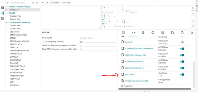

I have imported the empty_sysconfig_337zwt project (c2000ware 5.00.00) into CCS 12.8, I make changes to clock tree view but device's file doesn't change. I'm new to sysconfig.
Best regards
Welcome to the Sysconfig world.

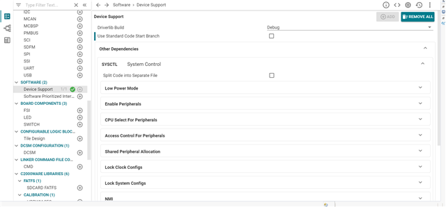

You would need to enable device support and include clocktree.h in your project build.
For example as shown below :
The selected options will appear in the clocktree.h file which you need to include in your project build
