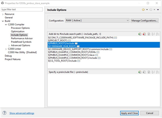

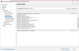

Part Number: TMS320F280049C
How do I add PMBUS_ROOT and C2000ware_DLIB_ROOT to include options?
I can't find it in any ti folders.
The one just like in this one.
These variables need to be added to the projectspec.
For e.g. : The f2838x_pmbus_target_example.projectspec has the following variables defined .
<pathVariable name="C2000WARE_DLIB_ROOT" path="../../../../../../driverlib/f2838x/driverlib/" scope="project" />
<pathVariable name="PMBUS_ROOT" path="../../" scope="project" />
Once the project is impored into CCS, these variables can be used in the Include options
