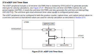

I found the execution time of  interrupt handler INT_myEQEP1_ISR(void) of Enhanced Quadrature Encoder Pulse (eQEP) Lab program is nearly 100 times per second in TMS320F28388D. please help me how to decrease and increase this execution time.
