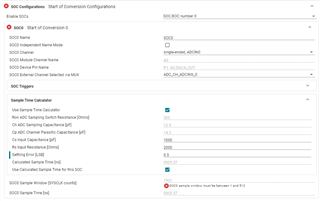

    Alternatively, the Sysconfig tool takes care of the sampling time calculation.  This is available under SOC Configurations->Sample Time calculation.  To use the calculator, enter the equivalent Thevenin resistance as Rs and enter the input cap as below:
    You would see that there is an error since the SOC sample window holds up to a maximum count of 511 SYSCLK cycles but with the external impedances involved, it requires a much larger sampling time for a half of an LSB settling accuracy.

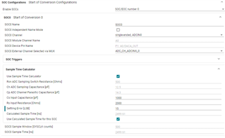

    Playing along with the values, if I put a settling accuracy of around 15 LSBs then error disappears since it requires about 500 SYSCLK cycles of settling time as shown below:
    You can do the same exercise on circuit #2 if you have the equivalent Thevenin circuit on the RC network.
    Bottomline, the accuracy of conversion is largely impacted by the external impedances.  Options to consider would be reducing the external RC values of introducing a buffer/driver after the external RC to isolate the external circuit from the ADC input pin.
