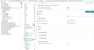

I attempted to create an application that reads the internal temperature sensor using ADC, triggered by ePWM. However, my application was unsuccessful.
I changed the clock sources in ClockTree within Sysconfig and added "Device Support". I have attached screenshots of the settings I modified. However, my application does not work.
If Device Support is not added in Sysconfig, my application functions very well. (The "device" folder was utilized in the empty project)
I tested the default clock settings in ClockTree after adding "Device Support," but my application does not work.
How can I properly use ClockTree with "Device Support"? Do I need to make any changes to utilize ClockTree effectively?

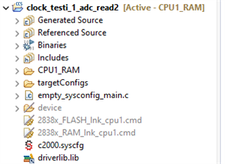

    Let me explain the issue. I opened a blank project using Resource Explorer. After that, I excluded the device folder and the cmd files within the project files in order to use the internal oscillator. Then, I configured the internal oscillator settings in the clock tree using Sysconfig. To make the clock tree settings effective, I added device support. Finally, I added a cmd file with the default settings. Since I wanted to use EPWM, I added the EPWM module as well. I wrote my program in the main.c file. However, when I ran the program, I noticed that the EPWM module was not working.
    To investigate why this might be happening, I looked at one of the example projects in Resource Explorer. I saw that device support was not being used in the example projects. Following the example, I removed the previously added device support from Sysconfig and re-included the device folder from the project files into my project. I know that as a result of this, the clock tree settings I made will be invalid. I did not change the EPWM settings in Sysconfig, nor did I change the cmd settings; I only removed device support and re-included the device folder. When I ran the program again, I noticed that the EPWM module was working.
    As a result, I realized that if I include device support in my project (I even tested this with the default clock tree settings), the EPWM module doesn't work. I don’t receive any warnings or errors in CCS.
    What should I do to enable epwm module? I didn't change anything except adding device support, adding cmd, adding adc and adding epwm. I didn't change sysctl or any other topics.

    Please add "device support" and "CMD" , and check if you change the EPWMCLKDIV in your clocktree, the associated field value in PERCLKDIVSEL Register has changed or not?
  • Hello Hadi,
    I can adjust the EPWMCLKDIV to /1 in the clock tree.
    I have reviewed the PERCLKDIVSEL:
    PERCLKDIVSEL has been set to 0.

    Over the weekend, I reviewed the clock settings in the technical reference manual. The PCLKCRx registers stood out to me (pages 270-295). I proceeded to activate the corresponding PCLKCRx register through sysconfig > sysctl > lock system configs > PCLKCR2.
    Subsequently, I enabled TBCLKSYNC in sysconfig > sysctl > enable peripherals > TBCLKSYNC (page 2915, section 26.4.3.2). Consequently, the EPWM module is now operational.
