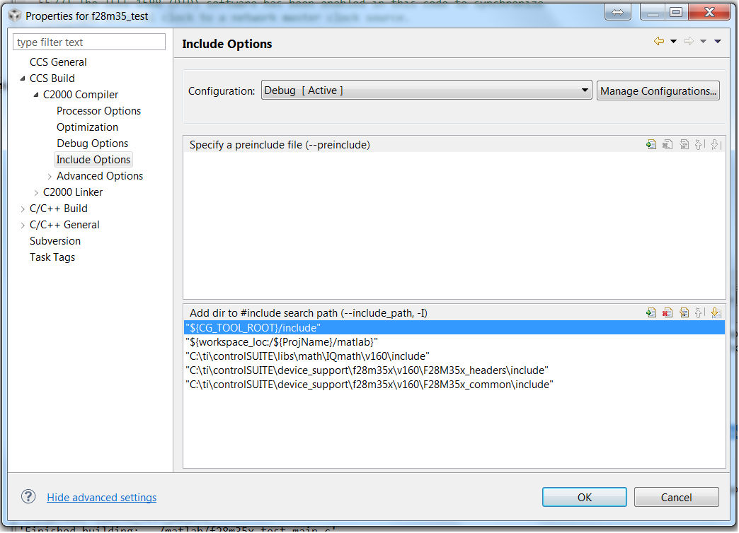

  • Hello Juan,
    Thank you so much for your response. Including the the needed variables did resolve the issue and I was able to build and load the example.
    However, I now enconter other problems. When I add any element to the example and try to rebuild it, I get build errors. For example, just by adding a GPIO output with a constant output, I get the errors in the picture and the compiler description below.
    Are you familiar with these types of errors?
    Thank you.
    Luis

  • Dear Luis,
    I believe you read the tutorial I previously attached in the thread ("How to create SImulink project for F28m35x processors"). In that document, I provided a CCSv5 project associated to the simulink model f28m35x_test.mdl that can be obtained from the following repository:
    https://f28m35x-simulink.googlecode.com/svn/trunk/f28m35x-simulink
     I recommend you to use this project as a template for your own CCS project. You must be added as a member to the project team to be able to download the source files. If you are interested, send me your email address and I invite you  (you can use the private conversation option that offers TI forum if you don't want to publish you email in this forum).
  • Hi again Luis,
    check the include options in the building setting panel and make sure that the paths are set correctly. Confirm that the folder hierarchy you use in your project is consistent with the structure showed in the include path window.
    If the error persists, send me your CCS project and I will take it a look.
