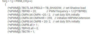

Part Number: TMS320F28386S
ACTUAL CODE_EX_3
for(j = 1;j < PWM_CH;j++)
        (*ePWM[j]).TBCTL.bit.PRDLD = TB_SHADOW;  // set Shadow load
        (*ePWM[j]).TBPRD = 20;               // PWM frequency = 1/(2*TBPRD)
        (*ePWM[j]).CMPA.bit.CMPA =20 / 2;   // set duty 50% initially
        (*ePWM[j]).CMPA.bit.CMPAHR = 255;   // initialize HRPWM extension
        (*ePWM[j]).CMPB.bit.CMPB = 20/ 2;   // set duty 50% initially
        (*ePWM[j]).CMPB.all |= 1 ;
        (*ePWM[j]).TBPHS.all = 0;
        (*ePWM[j]).TBCTR = 1;
        (*ePWM[j]).TBCTL.bit.CTRMODE = TB_COUNT_UPDOWN; // Select up-down
                                                        // count mode
        (*ePWM[j]).EPWMSYNCINSEL.all = SYNC_IN_SRC_DISABLE_ALL;
        (*ePWM[j]).EPWMSYNCOUTEN.all = SYNC_OUT_SRC_DISABLE_ALL;
        (*ePWM[j]).TBCTL.bit.HSPCLKDIV = TB_DIV1;
        (*ePWM[j]).TBCTL.bit.CLKDIV = TB_DIV1;          // TBCLK = SYSCLKOUT
        (*ePWM[j]).TBCTL.bit.FREE_SOFT = 11;
        (*ePWM[j]).CMPCTL.bit.LOADAMODE = CC_CTR_ZERO;  // LOAD CMPA on CTR = 0
        (*ePWM[j]).CMPCTL.bit.LOADBMODE = CC_CTR_ZERO;
        (*ePWM[j]).CMPCTL.bit.SHDWAMODE = CC_SHADOW;
        (*ePWM[j]).CMPCTL.bit.SHDWBMODE = CC_SHADOW;
        (*ePWM[j]).AQCTLA.bit.CAU = AQ_SET;             // PWM toggle high/low
        (*ePWM[j]).AQCTLA.bit.CAD = AQ_CLEAR;
        (*ePWM[j]).AQCTLB.bit.CBU = AQ_SET;             // PWM toggle high/low
        (*ePWM[j]).AQCTLB.bit.CBD = AQ_CLEAR;
        EALLOW;
        (*ePWM[j]).HRCNFG.all = 0x0;
        (*ePWM[j]).HRCNFG.bit.EDGMODE = HR_BEP;          // MEP control on
                                                         // both edges.
        (*ePWM[j]).HRCNFG.bit.CTLMODE = HR_CMP;          // CMPAHR and TBPRDHR
                                                         // HR control.
        (*ePWM[j]).HRCNFG.bit.HRLOAD = HR_CTR_ZERO_PRD;  // load on CTR = 0
                                                         // and CTR = TBPRD
        (*ePWM[j]).HRCNFG.bit.EDGMODEB = HR_BEP;         // MEP control on
                                                         // both edges
        (*ePWM[j]).HRCNFG.bit.CTLMODEB = HR_CMP;         // CMPBHR and TBPRDHR
                                                         // HR control
        (*ePWM[j]).HRCNFG.bit.HRLOADB = HR_CTR_PRD; // load on CTR = 0
                                                         // and CTR = TBPRD
        (*ePWM[j]).HRCNFG.bit.AUTOCONV = 1;        // Enable autoconversion for
                                                   // HR period
        (*ePWM[j]).HRPCTL.bit.TBPHSHRLOADE = 1;    // Enable TBPHSHR sync
                                                   // (required for updwn
                                                   //  count HR control)
        (*ePWM[j]).HRPCTL.bit.HRPE = 1;            // Turn on high-resolution
                                                   // period control.
        CpuSysRegs.PCLKCR0.bit.TBCLKSYNC = 1;      // Enable TBCLK within
                                                   // the EPWM
        (*ePWM[j]).TBCTL.bit.SWFSYNC = 1;          // Synchronize high
                                                   // resolution phase to
                                                   // start HR period
        EDIS;
THIS IS THE CODE WHERE WE MADE CHANGES.
OUR AIM: to achieve 2MHz signal .Based on the formula TBPRD =50 should give desired fequency but getting 800KHz.At what TBPRD we will gwt 2 MHz ?Please explain the error we are making.

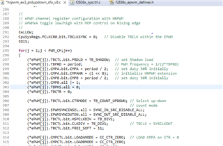

  • 1.Yes the original code ran without any issue.
    2.MY MODIFIED CODE WHERE I HAVE CHANGED THE VALUES ON THE RIGHT HAND SIDEACTUAL CODE_EX_3
    Changes made on : TBPRD,CMPA,CMPAHR,CM
    5.When I changed the TBPRD ,I am NOT seeing the PWM frequency change and respond proportionally.
