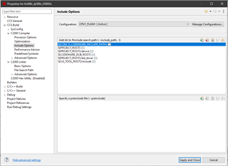

  • Can you share the include options in the project properties? It appears to be using C2000WARE 5.03, but in the compiler include options referencing 4.01.
  • Below pictures are settings from my side.
    Just double check with you,
    means below configuration page, right?
    means "complier settings" shown as below, right?
    If my understanding is right, I think these two page's version number must match in customer side because we can't change the version in "complier settings" page manually. I also try to change version in the page of "include option in project properties" just now and find  "complier settings" page will change with it.
    Please help correct me if there are something wrong.

  • Yes you are correct. Please let me know if this fixes the issue.
    Ryan Ma
  • Hi Ryan,
    It doesn't work. The version in C2000 complier page align with include option as below two pictures.
    We have a new discovery. There is no file generated below Generated Source - Sysconfig in customer side. But normal status have them. Do you know the reason?
