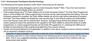

  • 1. If I don't unlock the zone and modify the value in secure ram or flash, what will happen? This will be two situations.
    I'm not sure whether you will get an error or if nothing will happen, either way, the write will be unsuccessful. I can test this on my side if needed.
    2. What was the original intention of DCSM to design two zones? Can I just use zone1 and not use zone2? For example, I place ASIL B code in zone1 secure area and place common code in zone1 unsecure code, can I protect ASIL B code?
    The purpose of two zones was to allow two developers to program code on the same device. For example, the primary developer may use a third party's code for some motor control algorithm but that third party could program their code in zone 2 to protect their proprietary code.
    3. If I place ASIL B code in zone1 secure area and place common code in zone2 unsecure code, can I protect ASIL B code and can ASIL B code can read the data in zone2 unsecure area?
    What do you mean "Zone 2 unsecure code"? Zone 2 code is secured by zone 2. Code in secure regions (zone 1 or zone 2) can read or write data in unsecure regions(unsecured by either zone)
    4. If I unlock the zone, it need to perform PFM flow, do we have testing report including how long does this flow will take? If I use correct password and wrong password, is the time required for this flow the same or different? If I use different wrong password(for example, right password is 0x1234567812345678, the wrong password is 0x123xxxxxxxxxxxxx and 0x1234xxxxxxxxxxxx) is the time required for this flow the same or different? customers afraid that the different PFM time will assist attackers in obtaining the correct password.
    There should be no difference in the PMF timing. There is no significant delay between when the zone becomes unlocked  and when the final instruction of the PMF flow occurs.
    5. In my understanding, the time of PFM flow is the time to excute the below code, right?
    That's correct. If you're concerned about the timing of the password match  flow being different depending on if the unlock was successful or not, you may want to replace the driverlib function with your own custom code where the timing of the code is not dependent on a successful or unsuccessful unlock.

  • Hi Sunny Zhou,
    By default the values in this register are "11" If the DCSM zone is locked and the register corresponding with a flash sector contains "11", that flash sector will be blocked, meaning no instruction fetches or data reads will be allowed from any source.
    The flash API should return an error if it attempts to write or erase a secure region.

  • Hi Shuqing,
    I may not be able to provide a test program until tomorrow as I'm busy with other things, however I can guarantee that any memory region that is secured by the DCSM cannot be read or written to by any code except code that is also secured by DCSM. For example, the flash API can only read or write secure memory if the flash API itself if stored in secure memory. For additional protection, you can designate a memory region as EXEONLY. This will block all data reads and writes from any source, only instruction fetches will be allowed.
    I will try to provide some sort of test program demonstrating this by tomorrow but I don't see why this is required.
