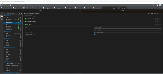

When I opened sysconfig, there is SyntaxError: Unexpected token '&&' like below picture.
the error wasn't occurred in my colleagues' PC. Only my PC had a problem.
CCS 12.7.1.00001
C2000 SysConfig (5.01.00.00)
Please let me know how to do.
Thanks.

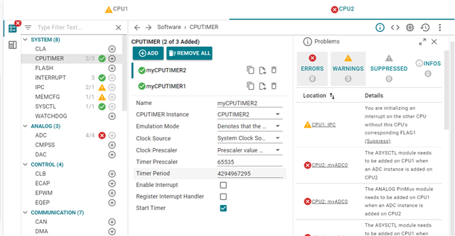

    Looks like there are some errors in the SysConfig file . See Snaphot below
    Are you seeing similar errors when you open the SysConfig file?
    Also, are you running a dual core example?
    Best Regards
    Siddharth

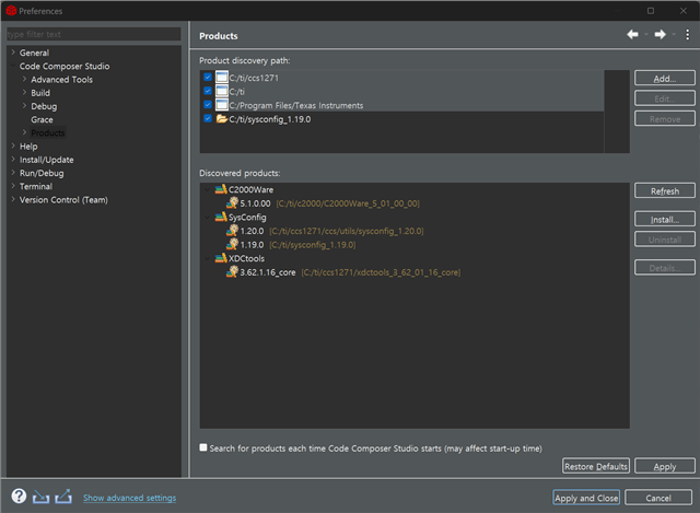

  • Hi, I checked development environments in our office.
    1. C2000ware version is same. (5.01.00.00)
    2. CCS version is different. (me: 12.7.1.00001, others: 12.6.0.00008)
    3. SysConfig version is different. (me: 1.20.0.3587, others: 1.19.0.3426)
    4. Compiler version is same (TI v22.6.1 LTS)
    We use same project files, so compiler option and build log is basically same. (directory is different)
    I can't open syscfg, but build and debug are running. but if I want to edit syscfg, I can't do it in my pc.
    Should I change my CCS and SysConfig version to same as colleague's?
    Thanks.
    Suggest you to have the same SysConfig version and see if it resolves the issue,
    Best Regards
    Siddharth

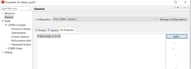

  • Hi, I installed SysConfig 1.19.0.3426 via https://www.ti.com/tool/download/SYSCONFIG/1.19.0.3426 and result is below.
    But, CCS still applied existing version like below.
    How to change the version? Should I click uninstall here?
    Thanks.
    You can select the product version to be used by the project.
    Right click on the project , click on Properties and select the General Tab . You can select the version in the Products tab as shown below
    Best Regards
    Siddharth
  • Hi, I changed SysConfig version, but the error is still exist.
