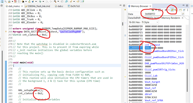

when I set a variable to a fixed RAM address,but when I use CCS for debug,and watch the value from memory browser I saw this variable still equal 0,but when I have initialized this value to 1, So why this ?
code configuration as below:
CMD configuration :
CCS memory browser result :

just add another information for this issue, I noticed that in .map file there is not address allocation for this varibale .

Please ensure the continuous refresh is enabled in your CCS Window.

I have enabled the continuous refresh in CCS Window but the value in address "0x008FFD" still 0 ,as below, is there any other reasons?
another findings : this variable “cnt_clatest” only defined but not used , if I used it as below, I will saw the value is 0x2, So it seems variable need be used or it can't be assigned the correct value?

Seems like RAM1 length overlaps RAM10 origin by a DWORD, surprised compiler does not flag a warning. Perhaps reduce extent RAM1 minus one word. Alternatively make RAM10 origin 0x00008FFE or 0x00008FFFF avoids a memory overlap.

I am still unable to replicate this issue. Once I had enabled continuous refresh with the original linker command settings for Ada, I was able to see the value in memory updated accordingly.
CAn you try moving line 185, after 186?

shorten RAM1 length to 0x000FF0(minus more than one word

There is an x49c errata, end of LSRAM sections must be defined 1 word below end length. Wondering if that could be the issue? Perhaps use CCS editor memory browser check if the #prama was copied to LSRAM section.
