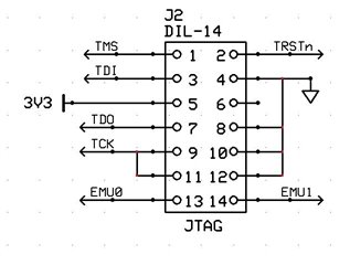

So, lately I've been developing an application using TMS320F28379D launchpad but now as I have developed my application using the launchpad and now I want to integrate my software to the hardware I have built, for the purpose I have bought XDS100V2 DSP EMULATOR but still I don't know how to do that it will be very grateful if anyone from you help me regarding this.
Some question which I already have are that does all the 14-pin JTAG EMULATOR have same pin out???? like I'm using this pinout as my reference but if JTAG pinout for 14-pin JTAG EMULATOR is different from manufacturer to manufacturer than I have to change the configuration.

    This picture is of the standard TI 14-pin JTAG header, which should be on the XDS100V2.
    Ben Collier

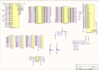

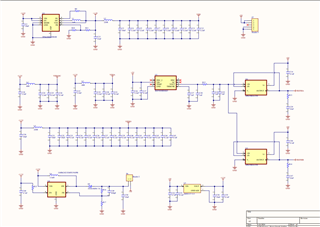

  • Hi Benjamin,
    This are the schematic of the custom board I have made is there any mistake in this because of which I'm not able to load the code in device.
    Vishwas

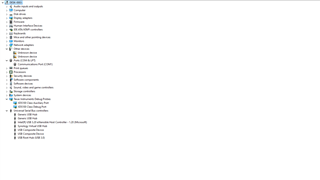

  • Hi Ben,
    May be this will give you a proper idea of what I'm doing and maybe you help me with the problem I'm facing.
    This is the screenshot of device manager in which there is texas instrument debug probe section but nothing in com port section is it a matter of concern?

    I am seeing in you schematic that there is a net called 'JTAG_TRST' which is different from TRST. What is JTAG_TRST?
