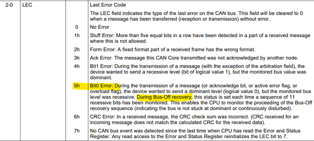

I don't understand how to verify that the bus-off is recovered and then clear CCCR.INIT?
MCAN_getProtocolStatus(MCANA_DRIVER_BASE,&ProtocolStatus);
If ProtocolStatus.lastErrCode has a value of not 0 or 7 to 7.I think the Bus-off has been recovered.
Is that right?
Hi Jinlong,
When the Init bit (CCCR.INIT) is cleared by your code, the MCAN module will then wait for 129 occurrences of Bus Idle (129 × 11 consecutive recessive bits) before resuming normal operation.
After the bus is recovered, the Bus-Off flag is cleared, and TX error counter is reset too.
The LEC might be 5. Each time when a sequence of 11 recessive bits is monitored, a Bit0 error code is written to the Error and Status Register.
