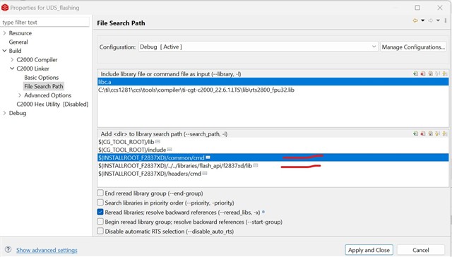

  • Hi Ryan,
    Thanks for the reply ,by adding nonBios.cmd it resolved the warnings.
    The thing is older project was created in compiler 3,same project I am trying to replicate in CCS with upgraded version 5.02 ,I am facing problem as below
    where can I find the documentation related to flash api and usage of F2837xD_CodeStartBranch.asm.
    I have also added build variable in as shown in image
    I am getting below warnings:
    #10210-D creating ".esysmem" section with default size of 0x400; use the -heap option to change the default size
    Build-variable 'INSTALLROOT_F2837XD' cannot be resolved. This project may not build as expected.
  • where can I find the documentation related to flash api and usage of F2837xD_CodeStartBranch.asm.
    Can you create a separate thread regarding this new issue? That way we can route that query to the correct expert.
    INSTALLROOT_F2837XD
    This does not seem to be a system variable in your CCS. If you're trying to point to the flash api folders it will be best to point it using the SDK location
    For me the location would be: C:\ti\c2000\C2000Ware_5_03_00_00\libraries\flash_api\f2837xd
