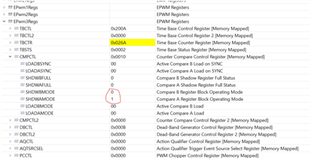

I tried using it like this:
        EPWM_setCounterCompareShadowLoadMode(EPWM3_BASE,
                                             EPWM_COUNTER_COMPARE_A,
                                             EPWM_COMP_LOAD_ON_CNTR_ZERO);
But the CMPCTL(SHDWAMODE bit) is still 1, i.e Immediate load mode!!
As per the TRM manual if SHDWAMODE is 1 , it is still in Immediate load mode!
    Shadow load mode is used by default for counter compare values as seen in the reset values listed for this register description:
    To disable the default shadow load mode and enable immediate mode, you would use the disable function:
    EPWM_disableCounterCompareShadowLoadMode()
    To debug your code, I would suggest stepping over your code - step over this function and refresh the register window to see if the correct settings have been enabled in regard to shadow loading on counter = 0. You can also check the values before programming the PWM to ensure that registers are at their reset state.
    Allison
  • Hi Allison, I cleared the cusfusion,
    Although EPWM_setCounterCompareShadowLoadMode does indeed set the pwm in shadow load mode, i am also using the Fast current loop library function FCL_initPWM() which sets the pwm back to immediate load mode using the EPWM_disableCounterCompareShadowLoadMode() function. I had overlooked this !
    You can close this thread.
    Thankyou!
