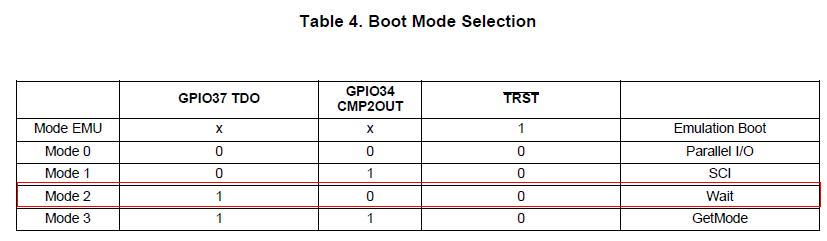

I have run into a serious problem: flash is locked for no reason.
I used TI demo board HVPSFB and the code, sometimes , it suddenly connot connect the target anymore and says it is locked or the device is not right.
everytime it happens,I have to replace 28027 with a new one to get work again.
this happend 4 times on two TI demo boards and 1 time on our board.
this is very probmatic and It happens not during programming flash,it is just in working mode.
 anybody experience similar problemsor any ideas?
