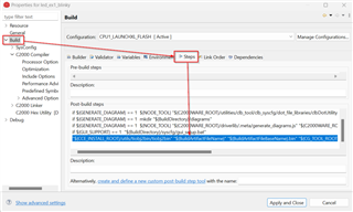

I use C:\ti\c2000\C2000Ware_5_03_00_00\driverlib\f28p65x\examples\c28x\led\led_ex1_blinky.c and CCS12.8.1 and Uniflash 8.7.0.
When I use CCS and Uniflash to load .out file, when I read memory is the same.
But when I load .bin file, memory data is different, and there is less 0xFF
my HEX utility setting is as below, I try to modify memwidth and romwidth to 8 and result is the same
I check .cmd generated from sysconfig, I am not sure if this is because there is no ALIGN(8) on codestart.
Could you please help to check this? Thanks!
Julia
  • Hi Julia,
    Please allow another day for this to be reviewed. Thanks!
    Allison
  • Hi Julia,
    I was able to fix this by using the tiobj2bin utility tool to generate the bin file instead of the C2000 Hex Utility:
    1. In your project's post-build steps, add the following line to generate the bin output:
    "${CCE_INSTALL_ROOT}/utils/tiobj2bin/tiobj2bin" "${BuildArtifactFileName}" "${BuildArtifactFileBaseName}.bin" "${CG_TOOL_ROOT}/bin/ofd2000" "${CG_TOOL_ROOT}/bin/hex2000" "${CCE_INSTALL_ROOT}/utils/tiobj2bin/mkhex4bin"
    2. Modify tiobj2bin.bat found at "C:\ti\ccs1280\ccs\utils\tiobj2bin\tiobj2bin.bat" with the following:

    3. Follow the steps in this E2E thread to fill the unused area with 0xFF instead of 0x00.
    4. Build the project. Now the correct .bin file will be generated with the 0xFFFF fill.
    Please let me know if you have any additional questions or roadblocks.
    Matt

  • Hi Julia,
    Have you tried using the binary output format (--binary)? With that, a ROMS directive is necessary as the binary option ignores holes between sections. You can get --binary to fill holes (with 0xFF for example) if you specify the system memory range with a ROMS directive and use the --image option. In effect, this is what the utility tiobj2bin does automatically for you.
    Here's how I was able to get it working with the --binary method:
    1. Configure Hex Utility's General Options as follows.
    2. Set the output format to be Binary (--binary) in the Output Format Options menu.
    3. Create a ROMS directive and move it into the relevant project Build Configuration folder (CPU1_FLASH, etc). Below is an example of my ROMS directive.
      1. ROMS
         flash : org = 0x100000, len = 0x10000
      2. Important: Note that I doubled the address and length of the ROMS directive (from 0x80000 and 0x8000) for a format that uses 16-bit ROM widths. Since the binary format supports only an 8-bit physical memory width and an 8-bit ROM width, the ROMS directive needs to have the origin and length specifications doubled when moving from a 16-bit format to an 8-bit format. Refer to Section 12.15.6 of TMS320C28x Assembly Language Tools v22.6.0.LTS User's Guide for an example.
    4. Specify the ROMS directive filename in the Command-line pattern.
    In summary, this are the settings to generate the bin output: --fill=0xFF --image --memwidth=16 --romwidth=16 --binary
    Matt
