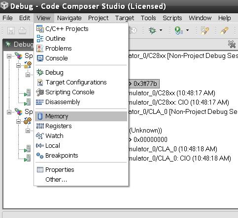

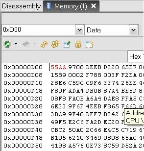

I want to boot a TMS320F28035 from SPI.  I understand from the comments in the example code that I must got to a place called 0xD00 and enter 0x55AA, then I must go to a place called 0xD01 and enter 0x0004.  There must be a button or a window in CCS4 that let's me do these things, but I can't find the TI documentation to explain how that works, at least not in SPRUGO0A, which I have already read cover to cover, but my eyes are bad so maybe I missed it.  What page?
