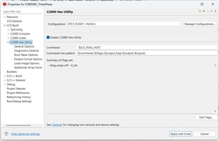

I would like help in fixing an error/warning  when attempting to verify/load a ".txt" file to a f280049 launchpad
The .txt file is the obtained by enabling the C2000 Hex Utility in code composer studio and selecting the TI-TXT hex format
I am using UniFlash version: 8.8.1.4983
The program was compiled using Code Composer Studio: Version: 12.8.1.00005

David Nyarko
    What were the options used to generate the hex files?
    ki

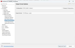

  • The only options i have are included in the screenshots below. The other "C2000 Hex Utility" do not have any entries or checked options.
    David
  • I believe for C2000 you typically need to set memwidth and romwidth to 16. There may be some other options needed.
    I'll bring this thread to the attention of the C2000 experts.
  • Thanks

    David
  • Hi David,
    Uniflash doesn't support the ti_txt file format. Please try using the hex format instead by leaving the output format dropdown blank in the C2000 Hex Utility. If this project is to be used with a flash kernel/sent over SCI, see the post build steps listed in Serial Flash Programming of C2000 Microcontrollers (Rev. H) section 3.
    Alex
  • Hi Alex,
    The purpose of the .txt option is to be sent over SCI. Regarding the post build steps since the Section 3 of the document you referenced mentioned  the following:
    This file format can even be generated as part of the Code Composer Studio build process by adding a post-build step with the following options: "${CG_TOOL_HEX}" "${BuildArtifactFileName}" -boot -sci8 -a -o "${BuildArtifactFileBaseName}.txt"
    Where can i enter that in the CCS properties for my project.
    David Nyarko
  • David,
    There are two ways to enter those properties:
    • In the C2000 Hex Utility menus, tick the options/select the dropdowns that match those command options
    • Disable the C2000 Hex Utility, then paste the "${CG_TOOL_HEX}..." string onto a new line in the Build > Steps > Post-build steps box
    Alex
