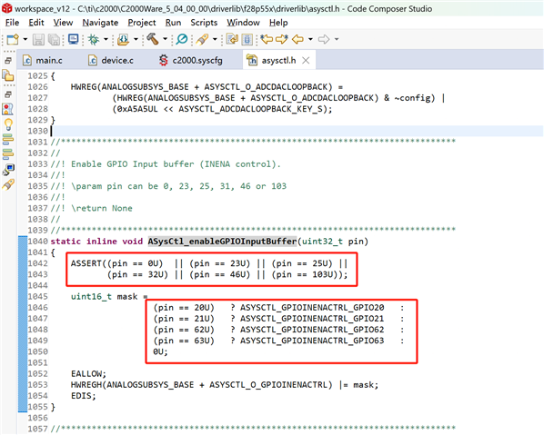

Please update the ASSERT check locally as below:
ASSERT((pin == 20U) || (pin == 21U) || (pin == 62U) || (pin == 63U));
This issue will be fixed in the next release.
