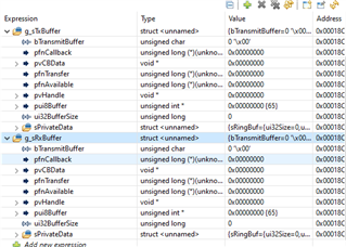

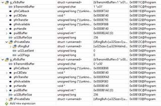

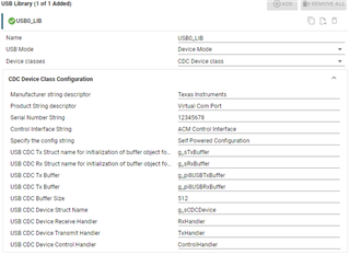

I am trying to use the USB on the CPU2. I followed the example usb_ex1_dev_serial and when the example everything works fine. However, when I use it on the CPU2 on my project I always get the problem when doing // Initialize the transmit and receive buffers.USBBufferInit(&g_sTxBuffer); and USBBufferInit(&g_sRxBuffer);  where it tells me that  "We do not have enough contiguous space following the current write pointer to satisfy the request so do not provide a buffer."
I added the configuration of my USB and  the value of both g_sTxBuffer and g_sRxBuffer for my project and the value of both when running the example.
    Can you share the map file for the project?  Would like to check where g_sTxBuffer and g_sRxBuffer are allocated in the memory map.

  • I added the map file for the project. Do you have any suggestions ?
  • Jad,
    Pls share the linker command file that you are using for CPU2.  Also, are you configuring the Dx RAMs where these buffers are allcocated to CPU2 in the code?
     D2-D5 memory blocks are mappable to either of the CPUs. Mapping of D2-D5 memory blocks is accomplished through MCUCNF1 register. When mapped to CPU1, D2-D5 memories cannot be accessed by CPU2. Conversely, when D2-D5 memories are mapped to CPU2, CPU1 does not have access to these memory blocks.
    // RAMD2 : origin = 0x008000, length = 0x002000 // Can be mapped to either CPU1 or CPU2. When configured to CPU1, use the address 0x01A000. User should comment/uncomment based on core selection
    // RAMD3 : origin = 0x00A000, length = 0x002000 // Can be mapped to either CPU1 or CPU2. When configured to CPU1, use the address 0x01C000. User should comment/uncomment based on core selection
    // RAMD4 : origin = 0x00C000, length = 0x002000 // Can be mapped to either CPU1 or CPU2. When configured to CPU1, use the address 0x01E000. User should comment/uncomment based on core selection
    // RAMD5 : origin = 0x00E000, length = 0x002000 // Can be mapped to either CPU1 or CPU2. When configured to CPU1, use the address 0x020000. User should comment/uncomment based on core selection
    Best Regards
    Siddharth
