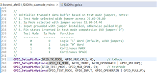

내가보기엔
dacmode 펌웨어에서는 dac 블럭의 출력으로 afe031과 통신하는 것 같은데,
아래 캡처한 사진의 코드에서 GPIO10 GPIO11 으로 설정되 어있는데
GPIO10 / GPIO11에서 DAC 변환 신호가 출력되면 AFE031에 전달되는 것이 아닌가?
SPI 통신이 아닌 DAC 신호만으로 통신하는 것 아닌가?
boostxl_afe031_f28004x_dacmode
어떻게 동작시키는지 좀알려주세요.

  • Hi Jungho,
    In the image you sent over, the GPIO10 and GPIO11 are configured as input signals, not output signals. They are simply reading the state of the test jumpers on the board, somewhere in the update loop / initialization, they are used to set the Test/Tx mode of the board

  • SPI 통신 신호는 어떤 핀에서 나오는 것인가?
    GPIO 설정함수가 너무 많은데 특정지을 수 가 없다.
    SCLK 에 High signal을 보내면 통신 신호가 나오는지?
    What pin does the SPI communication signal come from?
    There are too many GPIO configuration functions, so I can't specify one.
    If I send a high signal to SCLK, does the communication signal come out?
  • Hi Jungho,
    You may find the SPI configuration in the hal_spi.c file.
    Pasting the relevant section of the configuration below
    void InitAFESpiGpio()
        EALLOW;
        // SPI_MOSI
        GPIO_SetupPinOptions(16, GPIO_INPUT, GPIO_ASYNC | GPIO_PULLUP);
        // SPI_MISO
        GPIO_SetupPinOptions(17, GPIO_INPUT, GPIO_ASYNC | GPIO_PULLUP);
        // SPI_CS
        GPIO_SetupPinOptions(57, GPIO_INPUT, GPIO_ASYNC | GPIO_PULLUP);
        // SPI_CLK
        GPIO_SetupPinOptions(56, GPIO_INPUT, GPIO_ASYNC | GPIO_PULLUP);
        GPIO_SetupPinMux(16, GPIO_MUX_CPU1, 1);
        GPIO_SetupPinMux(17, GPIO_MUX_CPU1, 1);
        GPIO_SetupPinMux(57, GPIO_MUX_CPU1, 1);
        GPIO_SetupPinMux(56, GPIO_MUX_CPU1, 1);
        EDIS;
    In this example, the SPI FIFO is used to control the output of the SPI pins. The messages to the AFE should be directly written to the FIFO and the SPI module itself will handle the message transmission. There are some example waveforms in the boostxl user guide
    https://www.ti.com/lit/ug/sbou223/sbou223.pdf
    Peter
